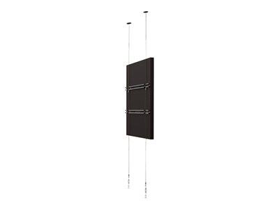

Peerless-AV DSF265P - Mounting kit for LCD / plasma panel. Screen size: 46"-65"
  • Ceiling attachment
    Includes Kwik-Loc self-locking cable joiners for quick and simple connection to truss or strut.
  • Display orientation
    Solutions available for both landscape and portrait display mounting.
  • Floor to ceiling
    Mounting solution for a flat panel display that attaches at any point along the cable making it ideal for store windows.
  • Cable tensioning
    Included turnbuckles provide cable tension, resulting in a plumb display.
Peerless-AV DSF265P mounting kit - for flat panel - silver
Mounting kit - ceiling mountable, in-floor mounted
Mounting Components
Ceiling plate, floor plate, VESA mount bracket, 2 steel cables
