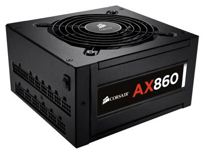

Corsair 860W AX860 80PLUS Platinum High Performance PSU
Quicklinx: 8D4VWS00 Mfr#: CP-9020044-UK
Discontinued
Compatible with 4th generation Intel® Core™ series processors
A new more efficient version of the awarding winning AX Series power supplies
Platinum Efficiency and Silent Fanless Mode
The Corsair AX860 power supply runs quieter, generates minimal excess heat and it's earned the 80 Plus® Platinum seal of approval, your guarantee that you're making the right choice for smart, efficient power delivery. Because the AX860 is so efficient it operates without the fan even spinning at low and moderate loads.

CORSAIR AX860 - power supply - 860 Watt
