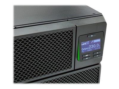

LCD graphics display has text and mimic diagrams that display modes of operation, system parameters and alarms. Connect the device to a network using a 10 or 100 BASE-T connection. Green mode bypasses unused electrical components in good power conditions to achieve very high operating efficiency without sacrificing any protection. Battery failure notification provides early-warning fault analysis on batteries enabling timely preventive maintenance. Rack / tower convertible protects the initial investment in the UPS when migrating from tower to rack-mount environment. Automatic internal bypass supplies utility power to the connected loads in the event of a UPS power overload or fault. Scalable runtime allows additional run time to be quickly added as needed. Intelligent battery management maximizes battery performance, life, and reliability through intelligent, precision charging.
  • LCD graphics display
    Text and mimic diagrams that display modes of operation, system parameters and alarms.
  • 10/100 BaseT connection
    Connect the device to a network using a 10 or 100 BaseT connection
  • Green mode
    Patent-pending operating mode that bypasses unused electrical components in good power conditions to achieve very high operating efficiency without sacrificing any protection.
  • Battery failure notification
    Provides early-warning fault analysis on batteries enabling timely preventive maintenance
  • Rack/Tower convertible
    Protects the initial investment in the UPS when migrating from tower to rack-mount environment.
