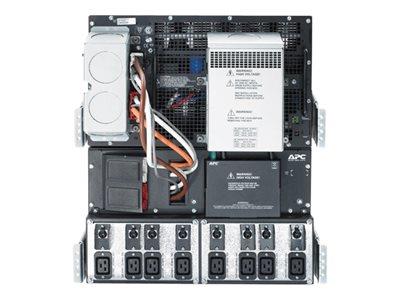

Increases availability by allowing the UPS to be connected to two separate power sources. Reduces preventative maintenance service needs by monitoring the health and status of the external batteries and their expected runtime.
Dual mains input
Increases availability by allowing the UPS to be connected to two separate power sources. -
LCD display
Manage the UPS locally through a text-based display that allows quick diagnosis via stored alarm conditions and events. -
Manageable external batteries
Reduces preventative maintenance service needs by monitoring the health and status of the external batteries and their expected runtime. -
Rack/Tower convertible
Protects the initial investment in the UPS when migrating from tower to rack-mount environment. -
Removable input/output wiring tray
Allows quick and easy installation and maintenance of the UPS. -
Single or three-phase input wireable
Provides flexibility for the UPS to be installed using either single or three-phase input wiring.
