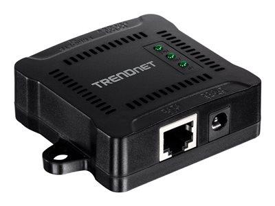

  • Install a non-PoE device in a remote location
  • Splits a Gigabit PoE signal into separate power and Gigabit data sources
  • Set the output power to either 5 V, 7.5 V, 9 V, or 12 V
  • Use this compact device with TRENDnet PoE switches or injectors
  • Save on installation and equipment costs
TRENDnet’s Gigabit PoE Splitter, model TPE-104GS, networks a non-PoE device in a remote location using a PoE network connection. The TPE-104GS splits a Gigabit PoE connection into separate power and Gigabit data sources. A handy toggle switch adjusts output power to 5 V, 7.5 V, 9 V, or 12 V in order to match non-PoE device power requirements. The included 2 and 2.5 mm jumper cables increase power pin device compatibility.

TRENDnet TPE-104GS - PoE splitter
Device Type
PoE splitter - external
60 g
Input Voltage
48 V
Output Voltage
5 / 7.5 / 9 / 12 V
Input Connectors
1 x RJ-45
Output connectors
1 x power DC jack 5.5 mm (ID: 2 mm)
7 cm x 4.5 cm x 2.5 cm
3-year warranty
