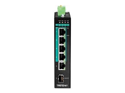

TRENDnet's TI-PG541 is a reliable IP30 unmanaged PoE+ DIN-rail switch with hardened components rated for extreme industrial environments. It offers four Gigabit PoE+ ports, one Gigabit port, one SFP slot, and a full PoE power budget of 120 watts. Dual redundant power inputs with overload current protection support zero downtime requirements. An alarm output can be triggered by a primary and/or redundant power failure.
  • Full PoE+ power budget
    Supplies up to 30 watts of PoE/PoE+ power per port with a 120 watt PoE power budget.
  • Integrated DIN-rail mount
    IP30 rated metal enclosure with integrated DIN-rail mounting hardware.
  • Redundant power
    Dual redundant power inputs with overload current protection.
  • Alarm output
    Alarm output is triggered by power failure of primary and/or redundant power.
  • Jumbo frame
    Sends larger packets, or jumbo frames, for increased performance.
  • Extreme temperatures
    Hardened switch is rated for an operating temperature range of -40 to 70 °C (-40 to 158 °F).
  • Electro magnetic compliance
    Complies with IEC61000-6-2 EMC generic standard immunity for industrial environments.
  • LED indicators
    LED indicators convey power, redundant power, alarm, SFP, and network port status.
  • Grounding point
    Grounding point protects equipment from external electrical surges.
