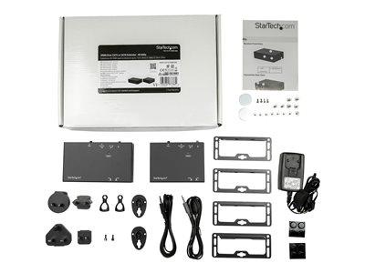

Extend HDMI over CAT5/CAT6 cabling to a remote location, with support for 4K 60Hz at 30 m (115 ft.) and 1080p 60Hz at 100 m (328 ft.). This HDMI over CAT6 extender transmits your HDMI audio/video signal to a remote location up to 70 m (230 ft.) away.
This HDMI over CAT6 extender maintains your Ultra HD 4K picture quality, even at 30 m (115 ft.) away from your video source. If you're not running 4K video, this extender supports High-Definition 1080p 60Hz and lower resolutions at even greater distances, up to 70 m (230 ft.) from your HDMI source.
With full support for your HDMI 2.0 equipment, including 4K resolution at 60Hz, this extender can transmit at a bandwidth of up to 18Gbps, making it the ideal solution for high-resolution tasks requiring the highest color detail. For smoother video and color transitions, the extender offers 4:4:4 chroma subsampling via visually lossless compression, meaning every pixel gets its own unique color.
With HDR support, you can enjoy lifelike images with increased contrast, brightness and colors and greater luminosity than standard digital imaging.
The HDMI Extender Over CAT6 offers a hassle-free solution for your digital signage project. The extender only requires a single CAT5e or CAT6 cable, so you can extend an HDMI signal using your building's existing infrastructure. Plus, this HDMI extender supports Power Over Cable (POC), which means you'll only need one power adapter connected to either your transmitter or receiver. Mounting hardware is also included for discreet, professional installation.
