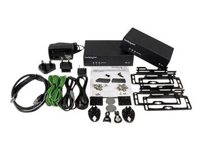

This extender has been specially crafted for a smooth, tidy setup. HDBaseT technology allows for single cable installation, for seamless integration using existing CAT5e or CAT6 infrastructure, avoiding the hassle of running multiple cables, while reducing potential failure points. Plus, the added benefit of power over cable means you'll only need one power source to power both your extender and receiver, great for extending to areas where power outlets may be limited. Mounting hardware is also included for both the extender and receiver for discrete, professional mounting.
