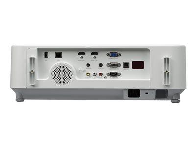

1 x VGA input - 15 pin HD D-Sub (HD-15) , 2 x HDMI input - 19 pin HDMI Type A , 1 x composite video input - RCA , 1 x audio line-in - RCA x 2 , 1 x audio line-in - mini-phone stereo 3.5 mm , 1 x VGA output - 15 pin HD D-Sub (HD-15) , 1 x audio line-out - mini-phone stereo 3.5 mm , 1 x serial RS-232 - 9 pin D-Sub (DB-9) , 1 x network - RJ-45 , 1 x USB - 4 pin USB Type B , 1 x USB 2.0 - 4 pin USB Type A
