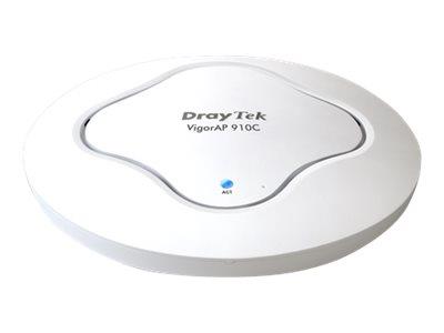

The DrayTek Vigor AP-910c is a wireless access point which can be operated in standalone or centrally managed/monitored mode (with the use of a central DrayTek management product - see later). The AP-910c is a high specification professional access point providing reliable and flexible coverage to all manner of applications. A vast array of security and management features helps the AP-910c improve and protect flexibility and integrity of your wireless LAN. The Vigor AP-910c is ideal for adding wireless connectivity to an existing LAN, or for expanding the range of an existing wireless LAN by using the WDS repeater features.
The ceiling format of the unit means that it can provide unobstructed coverage to the area around it and aesthetically blends into any home or office environment thanks to its shape, size and hidden cable entry. The AP-910c can also be wall mounted. For both options, a circular mounting plate (included with the unit) is fitted and then the AP-910c is attached. The AP-910c can be used together with our other access points (AP-710, AP-810 and AP-910c).
