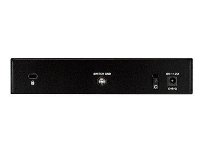

Power
Power Device
External power adapter
