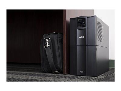

APC UPS 2kvA LCD 230V SmartConnect
Quicklinx: F3ZFWS00 Mfr#: SMT2200IC

APC Smart-UPS SMT2200IC - UPS - 1980 Watt - 2200 VA - Lead Acid - with APC SmartConnect
Device Type
UPS - external
48.8 kg
Input Voltage
AC 220/230/240 V
Output Voltage
AC 220/230/240 V ± 5%
Power Capacity
1980 Watt / 2200 VA
