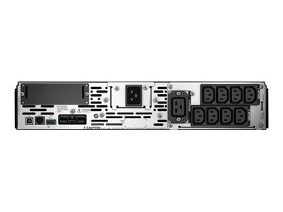

APC Smart-UPS X 2200 Rack/Tower LCD - UPS - 1.98 kW - 2200 VA
Device Type
UPS - external
Rack Size
2U
37.3 kg
Input Voltage
AC 208/220/230/240 V
Output Voltage
230 V ( 47 - 53 / 57-63 Hz )
Power Capacity
1.98 kW / 2200 VA
Output Connector(s)
8 x power IEC 320 EN 60320 C13 , 1 x power IEC 320 EN 60320 C19
Battery
Lead Acid
Batteries Qty
1
Run Time (Up To)
9.8 min at full load
Networking
RS-232, USB
43.2 cm x 66.7 cm x 8.5 cm
3 years warranty
Device Type
UPS - external
Height (Rack Units)
2U
Black
Power Device
UPS Technology
Line interactive
Input Voltage
Input Voltage Range
AC 141 - 255 / 160 - 280 V
Frequency Required
50/60 Hz
Input Connector(s)
3 x power IEC 320 EN 60320 C20, power CEE 7/7 (SCHUKO), power BS 1363A
Power Output Connectors Details
Output Voltage
Power Capacity
1.98 kW / 2200 VA
Output Waveform
Sinewave
Surge Suppression
Yes
Surge Energy Rating
645 Joules
Circuit Protection
Circuit breaker
Battery
Quantity
1
Technology
Lead Acid
Run Time (Up To)
9.8 min at full load , 25.3 min at half load
Recharge Time
3 hours
Networking
Remote Management Interface
RS-232, USB
Expansion / Connectivity
Interfaces
1 x USB , 1 x serial - RJ-45 , 1 x EPO (emergency power off)
Expansion Slot(s)
1 (total) / 1 (free) x SmartSlot
Cables Included
1 x serial cable , 1 x USB cable , 1 x power cable - 1.8 m
Rack Mounting Kit
Included
Audible alarm, LCD display, Automatic Voltage Regulation (AVR), LED indicators, overload protection, automatic self-test
CSA, C-Tick, GOST, UL 1778, VDE, IEC 60950, EN 50091-2, IRAM, RoHS, EN 50091-1, FCC Part 15 A, REACH
Software Included
Drivers & Utilities
3 years warranty
Service & Support Details
Limited warranty - 3 years , Limited warranty - batteries - 2 years
Min Operating Temperature
0 °C
Max Operating Temperature
40 °C
Humidity Range Operating
0 - 95%
Sound Emission
55 dBA
Dimensions & Weight
43.2 cm
66.7 cm
8.5 cm
37.3 kg
Shipping Width
59.6 cm
Shipping Depth
86.9 cm
Shipping Height
24.3 cm
Shipping Weight
45.4 kg
