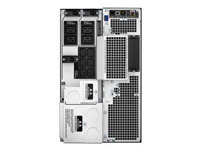

APC Smart-UPS SRT 8000VA - UPS - 8000 Watt - 8000 VA
Device Type
UPS - rack-mountable / external
Rack Size
6U
111.82 kg
Input Voltage
AC 230 V
Output Voltage
AC 230 V ± 3%
Power Capacity
8000 Watt / 8000 VA
Input Connectors
Hardwire 5-wire (3PH + N + G), hardwire 3-wire (1PH + N + G)
Output connectors
6 x power IEC 60320 C13 , 4 x power IEC 60320 C19 , 1 x hardwire 3-wire (HN + G) , 3 x IEC connector
Battery
Lead Acid
Run Time (Up To)
5.3 min at full load
Networking
Ethernet 10/100, USB
Black
26.3 cm x 71.5 cm x 43.2 cm
3-year warranty
Device Type
Height (Rack Units)
6U
Black
Power Device
UPS Technology
On-line
Input Voltage
AC 230 V
Frequency Provided
50/60 Hz
Frequency Required
45 - 65 Hz
Input Connectors
Power Output Connectors Details
Output Voltage
AC 230 V ± 3% - 50/60 Hz
Power Capacity
8000 Watt / 8000 VA
Output Waveform
Sinewave
Surge Suppression
Yes
Surge Energy Rating
480 Joules
Efficiency
98%
Battery
Technology
Lead Acid
Run Time (Up To)
5.3 min at full load , 14.8 min at half load
Recharge Time
3 hours
Maintenance free, sealed, leak-proof
Networking
Remote Management Interface
Expansion / Connectivity
Interfaces
1 x management (Ethernet) - RJ-45 , 1 x management (USB) - 4 pin USB Type B , 1 x EPO (emergency power off) , 1 x serial - RJ-45
Expansion Slots
1 (total) / 1 (free) x SmartSlot
Audible alarm, LCD display
C-Tick, VDE, IEC 60950, EN 50091-2, RoHS, EN 50091-1, REACH, EN 62040-2, IP20, EAC
Software Included
APC PowerChute Business Edition
Limited warranty - 3 years , Limited warranty - batteries - 2 years
Min Operating Temperature
0 °C
Max Operating Temperature
40 °C
Humidity Range Operating
0 - 95% (non-condensing)
Sound Emission
55 dBA
Dimensions & Weight
26.3 cm
71.5 cm
43.2 cm
111.82 kg
Shipping Width
60 cm
Shipping Depth
100 cm
Shipping Height
46.1 cm
Shipping Weight
126.82 kg
