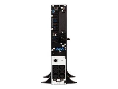

APC SMART-UPS SRT 1500VA 230V
Quicklinx: GF07WS00 Mfr#: SRT1500XLI
Power Rating: 1500Watt
£1,204.45 ex VAT
£1,445.34 inc VAT
High density, double-conversion on-line power protection with scalable runtime.
  • LCD graphics display
    Text and mimic diagrams that display modes of operation, system parameters and alarms.
  • ECO Mode
    Operating mode that by-passes unused electrical components in good power conditions to achieve high operating efficiency without sacrificing protection.
  • Battery failure notification
    Provides early-warning fault analysis on batteries enabling timely preventive maintenance
  • Rack/Tower convertible
    Protects the initial investment in the UPS when migrating from tower to rack-mount environment.
APC Smart-UPS SRT 1500VA - UPS - 1500 Watt - 1500 VA
Device Type
UPS - Power Factor Correction (PFC) - rack-mountable / external
20.5 kg
Input Voltage
AC 220/230/240 V
Output Voltage
AC 220/230/240 V ± 2%
Power Capacity
1500 Watt / 1500 VA
Input Connectors
Power IEC 60320 C14, power BS 1363A, Europlug (power CEE 7/16)
Output connectors
6 x power IEC 60320 C13
Battery
Lead Acid
Batteries Qty
1
Run Time (Up To)
5.2 min at full load
Networking
USB, serial
Black
8.5 cm x 50.5 cm x 43.2 cm
3-year warranty
Device Type
Black
Power Device
UPS Technology
On-line
Input Voltage
AC 220/230/240 V
Input Voltage Range
AC 100 - 275 V
Frequency Provided
50/60 Hz ± 3Hz
Frequency Required
40 - 70 Hz
Input Connectors
Power Output Connectors Details
Output Voltage
AC 220/230/240 V ± 2% - 50/60 Hz
Power Capacity
1500 Watt / 1500 VA
Output Waveform
Sinewave
Surge Suppression
Yes
Surge Energy Rating
432 Joules
Circuit Protection
Circuit breaker
Efficiency
92% at 100% Load
Battery
Quantity
1
Technology
Lead Acid
Voltage Provided
48 V
Run Time (Up To)
5.2 min at full load , 14.2 min at half load
Recharge Time
3 hours
Maintenance free, sealed, leak-proof
Networking
Remote Management Interface
USB, serial
Expansion / Connectivity
Interfaces
1 x serial - RJ-45 , 1 x EPO (emergency power off) , 1 x USB
Expansion Slots
1 (total) / 1 (free) x SmartSlot
Cables Included
Power cable 1.83 m , USB cable - external
Audible alarm, LCD display, internal bypass, cold-start function, firmware upgradable, hot-swappable batteries, Eco-Mode, auto restart
REACH, IP20, EAC
Software Included
APC PowerChute Business Edition
Limited warranty - 3 years , Limited warranty - batteries - 2 years
Min Operating Temperature
0 °C
Max Operating Temperature
40 °C
Humidity Range Operating
0 - 95% (non-condensing)
Sound Emission
50 dBA
Dimensions & Weight
8.5 cm
50.5 cm
43.2 cm
20.5 kg
Shipping Width
59.4 cm
Shipping Depth
74.9 cm
Shipping Height
24.6 cm
Shipping Weight
29.6 kg
