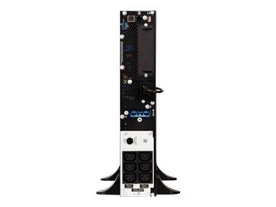

APC Smart-UPS SRT 1000VA - UPS - 1000 Watt - 1000 VA
Device Type
UPS - Power Factor Correction (PFC) - rack-mountable / external
20.5 kg
Input Voltage
AC 230 V
Output Voltage
AC 220/230/240 V ± 2%
Power Capacity
1000 Watt / 1000 VA
Input Connectors
1 x power IEC 60320 C14, power BS 1363A, Europlug (power CEE 7/16)
Output connectors
6 x power IEC 60320 C13
Battery
Lead Acid
Run Time (Up To)
8.5 min at full load
Networking
RS-232, USB
Black
43.2 cm x 50.5 cm x 8.5 cm
Environmental Standards
ENERGY STAR
3-year warranty
Device Type
Black
Power Device
UPS Technology
On-line
Input Voltage
AC 230 V
Input Voltage Range
AC 50 - 150 / 80 - 150 V
Frequency Provided
50/60 Hz ± 3Hz
Frequency Required
40 - 70 Hz
Input Connectors
Power Output Connectors Details
Output Voltage
AC 220/230/240 V ± 2% - 50/60 Hz
Power Capacity
1000 Watt / 1000 VA
Output Waveform
Sinewave
Surge Suppression
Yes
Surge Energy Rating
432 Joules
Circuit Protection
Circuit breaker
Battery
Technology
Lead Acid
Run Time (Up To)
8.5 min at full load , 21.1 min at half load , 9.8 min at 900 Watts , 13.8 min at 700 Watts , 59.6 min at 200 Watts
Recharge Time
3 hours
Maintenance free, sealed, leak-proof
Networking
Remote Management Interface
RS-232, USB
Expansion / Connectivity
Interfaces
1 x management (RS-232) - RJ-45 , 1 x EPO (emergency power off) , 1 x management (USB)
Expansion Slots
1 (total) / 1 (free) x SmartSlot
Cables Included
Power cable 1.83 m , USB cable - external
Audible alarm, LCD display, internal bypass, LED indicators, cold-start function, firmware upgradable, automatic self-test, hot-swappable batteries, Eco-Mode, reset breaker
RoHS, REACH, IP20, EAC
Software Included
APC PowerChute Business Edition
Sustainability Information
ENERGY STAR
Yes
Limited warranty - 3 years , Limited warranty - batteries - 2 years
Min Operating Temperature
0 °C
Max Operating Temperature
40 °C
Humidity Range Operating
0 - 95% (non-condensing)
Sound Emission
50 dBA
Dimensions & Weight
43.2 cm
50.5 cm
8.5 cm
20.5 kg
Shipping Width
59.4 cm
Shipping Depth
74.9 cm
Shipping Height
24.6 cm
Shipping Weight
29.6 kg
