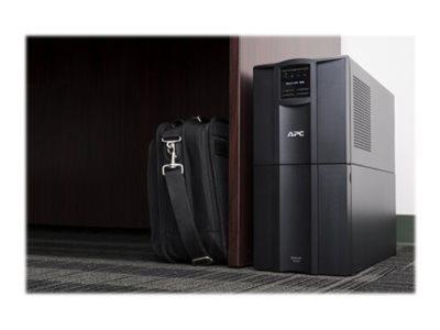

APC Smart UPS SMT3000IC
Quicklinx: FCKBWS00 Mfr#: SMT3000IC
Power Rating: 2700watt

APC Smart-UPS SMT3000IC - UPS - 2700 watt - 3000 VA - with APC SmartConnect
Device Type
UPS - external
52.5 kg
Input Voltage
AC 220/230/240 V
Output Voltage
AC 220/230/240 V ± 5%
Power Capacity
2700 watt / 3000 VA
Input Connectors
1 x power IEC 60320 C20
Output connectors
8 x power IEC 60320 C13 , 2 x IEC jumper , 1 x power IEC 60320 C19
Battery
Lead Acid
Batteries Qty
1
Run Time (Up To)
5.1 min at full load
Networking
RS-232, USB
Black
19.7 cm x 54.4 cm x 43.5 cm
3-year warranty
