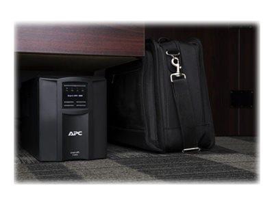

APC Smart-UPS 1000VA LCD 230V

Intelligent and efficient network power protection from entry level to scalable runtime. Ideal UPS for servers, point-of-sale, routers, switches, hubs and other network devices.
  • Cold-start capable
    Provides temporary battery power when the utility power is out.
  • Energy meter
    Provides actual kilowatt hours of usage for energy conscious users.
  • Green mode
    Patent-pending operating mode that bypasses unused electrical components in good power conditions to achieve very high operating efficiency without sacrificing any protection.
  • High online efficiency
    Reduces utility costs, generates less heat.
  • Intelligent Card Slot
    Mini slot supports various optional management cards which provide basic or essential monitoring, management and control features for the UPS.
  • Intuitive LCD interface
    Provides clear and accurate information in multiple languages with the ability to configure the UPS locally with easy to use navigation keys.
  • Predictive replace battery date
    Dynamically provides the month and year when battery replacement is recommended to aide in long term maintenance planning.
  • Pure sine wave output on battery
    Simulates utility power to provide the highest degree of compatibility for active PFC (power factor corrected) servers and sensitive electronics.
  • Single switched outlet group
    Single outlet group that may be controlled separately from the UPS for discrete reboot of hung devices, sequenced on/off and non-critical load shedding.
  • SmartConnect
    Innovative, easy to use remote monitoring feature that provides automatic notifications, firmware updates, and advanced support services.
  • Temperature-compensated battery charging
    Prolongs battery life by regulating the charge voltage according to battery temperature.
