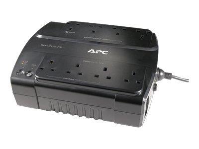

APC Power-Saving Back-UPS ES 8 Outlet 550VA 230V
Quicklinx: 71YMWS00 Mfr#: BE550G-UK
Discontinued
APC's Back-UPS provides enough battery backup power so you can work through short and medium length power outages. It also safeguards your equipment against damaging surges and spikes that travel along utility, phone and networks lines. Along with the rest of its standard features, like compatibility with our auto-shutdown software, the Back-UPS 550 is the perfect unit to protect your productivity from the constant threat of bad power and lost data.
Battery Backup & Surge Protected Outlets keep a computer, monitor and other critical devices running when the power goes out or fluctuates outside safe levels.
Surge Only Outlets protect printers, faxes or other non-critical devices without reducing battery capacity.
Data Line Surge Protection guards against surges and spikes traveling over analog phone line or Ethernet network lines
Auto Shutdown Software allows management of the Back-UPS from your computer via USB interface:
Saves files and shuts down system when battery is low
Records utility power and battery conditions
Allows for customized set up LED Status Indicator and Audible Alarms.
Push Button Circuit Breaker - enables quick recovery from overloads.
3 Yr Warranty (in E.U.), and free technical support via phone and web.
Automatic Diagnostic Testing ensures your unit is ready when you need it.
  • User-replaceable batteries
    Increases availability by allowing a trained user to perform upgrades and replacements of the batteries reducing Mean Time to Repair (MTTR)
  • Audible alarms
    Provides notification of changing utility power and UPS power conditions
  • Automatic self-test
    Periodic battery self-test ensures early detection of a battery that needs to be replaced
  • Cold-start capable
    Provides temporary battery power when the utility power is out
  • Battery failure notification
    Provides early-warning fault analysis on batteries enabling timely preventive maintenance
  • Battery replacement without tools
    Enables fast battery replacement, lowering Mean Time to Repair (MTTR)
  • Safety-agency approved
    Ensures the product has been tested and approved to work safely with the connected service provider equipment and within the specified environment
  • Hot-swappable batteries
    Ensures clean, uninterrupted power to protected equipment while batteries are being replaced
  • Battery-protected and surge-only outlets
    Reserves power capacity and run time for connected equipment that require UPS battery back-up while providing surge only protection for less critical equipment
  • Dataline surge protection
    Provides protection of connected equipment from power surges on the data lines
  • USB connectivity
    Provides management of the UPS via a USB port (not available on all models)
  • Adjustable voltage sensitivity
    Provides the ability to adapt the UPS for optimal performance in specific power environments or generator applications
