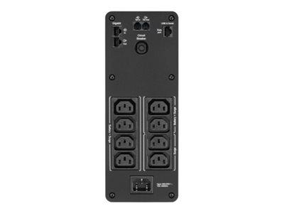

APC Back-UPS Pro BR1200SI - UPS - 720 Watt - 1200 VA
Device Type
UPS - external
11.7 kg
Input Voltage
AC 220-240 V
Output Voltage
AC 220-240 V
Power Capacity
720 Watt / 1200 VA
Input Connectors
1
Output connectors
6 x power (UPS and surge) , 2 x power (surge)
Battery
Lead Acid
Batteries Qty
1
Networking
USB
Black
10 cm x 36.8 cm x 26 cm
2-year warranty (European Union - 3 years)
Device Type
UPS - external
Black
Power Device
UPS Technology
Line interactive
Input Voltage
AC 220-240 V
Input Voltage Range
AC 176 - 294 V
Frequency Required
50/60 Hz ± 3Hz
Input Connectors
1
Power Output Connectors Details
Output Voltage
AC 220-240 V
Power Capacity
720 Watt / 1200 VA
Dataline Surge Protection
Ethernet 10/100/1000Base-T - RJ-45 - 1 input line / 1 output line , Phone line - 1 input line / 1 output line
Output Waveform
Stepped approximation to a sinewave
Battery
Quantity
1
Technology
Lead Acid
Recharge Time
16 hours
Sealed
Networking
Remote Management Interface
USB
Expansion / Connectivity
Interfaces
Management (USB)
Audible alarm, LCD display, Automatic Voltage Regulation (AVR), overload protection, dataline protection
IP20
Software Included
APC PowerChute Personal Edition
Limited warranty - replace or repair - 2 years , European Union: limited warranty - replace or repair - 3 years
Min Operating Temperature
0 °C
Max Operating Temperature
40 °C
Dimensions & Weight
10 cm
36.8 cm
26 cm
11.7 kg
