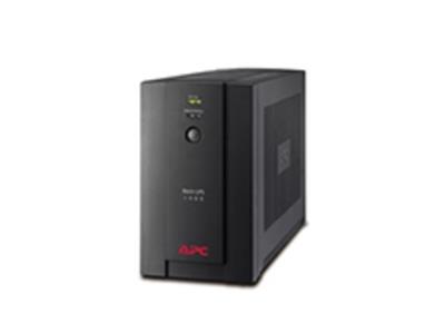

- Product Description
- APC Back-UPS 950VA - UPS - 480 Watt - 950 VA
- Device Type
- UPS - external
- Weight
- 8 kg
- Input Voltage
- AC 230 V
- Output Voltage
- AC 230 V
- Power Capacity
- 480 Watt / 950 VA
- Input Connectors
- 1 x power IEC 60320 C14
- Output connectors
- 6 x power IEC 60320 C13 (UPS and surge)
- Battery
- Lead Acid
- Batteries Qty
- 1
- Run Time (Up To)
- 1 min at full load
- Networking
- USB
- Colour
- Black
- Dimensions (WxDxH)
- 13 cm x 33.6 cm x 21.5 cm
- Manufacturer Warranty
- 2-year warranty
- Device Type
- UPS - external
- Colour
- Black
Power Device
- UPS Technology
- Line interactive
- Input Voltage
- AC 230 V
- Input Voltage Range
- AC 150 - 280 V
- Frequency Provided
- 50/60 Hz
- Frequency Required
- 50/60 Hz
- Input Connectors
- Power Output Connectors Details
- Output Voltage
- AC 230 V 50/60 Hz
- Power Capacity
- 480 Watt / 950 VA
- Dataline Surge Protection
- Phone line - RJ-11
- Output Waveform
- Stepped approximation to a sinewave
- Surge Suppression
- Yes
- Surge Energy Rating
- 273 Joules
- Circuit Protection
- Circuit breaker
Battery
- Quantity
- 1
- Technology
- Lead Acid
- Run Time (Up To)
- 1 min at full load , 8 min at half load
- Recharge Time
- 8 hours
- Features
- Maintenance free, sealed, leak-proof
Networking
- Remote Management Interface
- USB
Expansion / Connectivity
- Interfaces
- 1 x management (USB) - 4 pin USB Type B
- Cables Included
- Power cable 1.22 m
- Features
- Audible alarm, audible alarm, Automatic Voltage Regulation (AVR), LED indicators, automatic self-test
- Compliant Standards
- C-Tick, IEC 62040-1-1, RoHS, A-Tick, REACH, RCM
- Service & Support
- Limited warranty - 2 years
- Min Operating Temperature
- 0 °C
- Max Operating Temperature
- 40 °C
- Humidity Range Operating
- 0 - 95%
- Sound Emission
- 45 dBA
Dimensions & Weight
- Width
- 13 cm
- Depth
- 33.6 cm
- Height
- 21.5 cm
- Weight
- 8 kg
- Shipping Width
- 24.5 cm
- Shipping Depth
- 44 cm
- Shipping Height
- 29.5 cm
- Shipping Weight
- 8.99 kg
