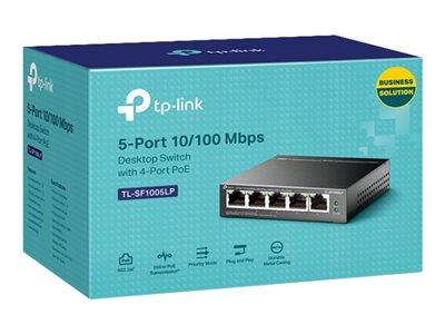

TP LINK 5-Port 10/100Mbps Desktop Switch With 4-Port PoE
Quicklinx: G6XCWS00 Mfr#: TL-SF1005LP
Type: Fast Ethernet
Ports: 5
Data Transfer Rate: [N/A]
Managed: No
POE: PoE
46 In Stock
£24.48 ex VAT
£29.37 inc VAT
TL-SF1005LP is a 5 10/100 Mbps ports unmanaged switch that requires no configuration and provides 4 PoE (Power over Ethernet) ports. It can automatically detect and supply power with all IEEE 802.3af compliant Powered Devices (PDs). In this situation, the electrical power is transmitted along with data in one single cable allowing you to expand your network to where there are no power lines or outlets, where you wish to fix devices such as APs, IP Cameras or IP Phones, etc.
  • Power Over Ethernet
    Four of the 5 Auto-Negotiation RJ45 ports (port-1 to port-4) of the switch support Power over Ethernet (PoE) function. These PoE ports can automatically detect and supply power with those IEEE 802.3af compliant Powered Devices (PDs).
  • Overload arrangement
    TL-SF1005LP has the priority function which will help protect the system when the system power is overloaded. If all PoE PDs power consumption is >= 41 W, a priority will be arranged among the PoE ports, then the system will cut off the power of the lowest-priority port.
  • Intelligent power management
    Priority (port-1=port-2=port-3>port-4): this function will help to ensure the normal operation of the system; it means Port 4 will be cut off when all total PoE PDs power consumption exceeds 41 W. For example. If port 1, 2 and 4 are consuming 10 W respectively, and an additional PoE device with 15.4 W is inserted to port 3, the system will cut off the power of port 4 to compensate for the overload.
  • Ease of use
    TL-SF1005LP is easy to install and use. It requires no configuration and installation. With desktop and wall mountable design, outstanding performance and quality, the TP-Link's TL-SF1005LP 5-Port 10/100 Mbps Desktop Switch with 4-Port PoE is an ideal choice for expanding your network.
