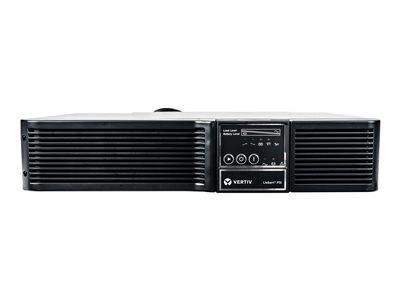

Liebert PSI 1500VA (1350W) UPS
Quicklinx: 7BF4WS00 Mfr#: PS1500RT3-230
Discontinued
Liebert PSI 1500VA is a compact, line-interactive UPS system designed especially for IT applications such as network closets and small data centers. The flexible design of Liebert PSI allows the UPS to be configured as a self-standing tower or to be rack-mounted within a 2U space. It provides reliable power protection for servers, critical nodes, network workstations, large network peripherals, network routers, bridges, and other electronic equipment.
  • Efficient power management
    The Liebert PSI UPS features line interactive UPS technology, ensuring efficient power management and protection against power outages and fluctuations. Its sinewave output waveform ensures a smooth and consistent power supply to connected devices.
  • Rapid recharge capability
    Equipped with hot-swappable batteries that recharge in just 5 hr, the Liebert PSI UPS minimizes downtime, ensuring your operations are back up and running quickly after a power disruption.
  • Comprehensive connectivity
    This UPS offers a variety of connectivity options including RS-232 and USB interfaces, allowing for easy management and monitoring of the power supply system. The inclusion of an EPO (emergency power off) port adds an extra layer of safety in critical situations.
  • Designed for durability
    The Liebert PSI UPS comes with a robust plug-in module design and is compliant with RoHS standards, ensuring reliable performance in a range of environmental conditions, from 0°C to 40°C.
Liebert PSI PS1500RT3-230 - UPS - 1350 Watt - 1500 VA
