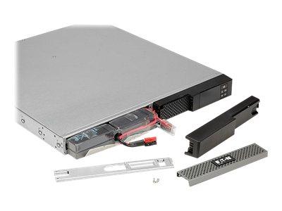

The Eaton 5P is a 650VA line interactive rack UPS with the Automatic Voltage Regulation (AVR), a sinewave output and an advanced, multilingual LCD display with energy metering features. The 5P possesses 4IEC outlets including 2 remotely manageable outlets and hot swappable batteries. In order to increase battery lifetime, this UPS includes the Advanced Battery Management (ABM) technology. The 5P also features a connector for remote power off or remote on off function.
  • Manageability
    The graphical LCD display provides clear information on the UPS's status and measurements on a single screen (in seven languages). Enhanced configuration capabilities are also available with easy-to-use navigation keys. Load segment control enables prioritized shutdowns of nonessential equipment during outages in order to maximize battery runtime for critical devices. Load segment control can also be used to remotely reboot locked-up network equipment or to manage scheduled shutdowns and sequential start-ups.
  • Performance and efficiency
    Energy efficient UPS: with an optimized electrical design, the 5P provides up to 98% efficiency, reducing cooling and utility costs.
  • Pure sinewave output
    When operating in battery mode, the 5P provides a high quality output signal for any sensitive equipment connected, such as active PFC (power factor corrected) servers.
  • Adjustable tolerance and sensitivity
    Users can maximize useful battery life by widening the input voltage window or adjustable input waveform sensitivity (via the LCD or software) to adapt the UPS to a specific environment (like Genset).
  • Stronger, longer battery life
    Eaton ABM battery management technology uses an innovative three-stage charging technique that extends batteries by up to 50%.
