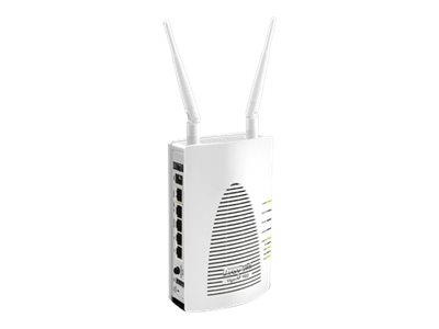

The DrayTek VigorAP 902 is a wireless access point which can be operated in standalone or centrally managed/monitored mode (with the use of a central DrayTek management product - see later). The VigorAP 902 is a high specification professional access point providing reliable and flexible coverage to all manner of applications. A vast array of security and management features helps the AP to improve and protect flexibility and integrity of your wireless LAN. The VigorAP 902 is ideal for adding wireless connectivity to an existing LAN, or for expanding the range of an existing wireless LAN by using the WDS repeater features.

- Product Description
- Draytek VigorAP 902 - radio access point - Wi-Fi 5
- Device Type
- Radio access point
- Form Factor
- External
- Localisation
- United Kingdom, Ireland
- Data Link Protocol
- IEEE 802.11b, IEEE 802.11a, IEEE 802.11g, IEEE 802.11n, IEEE 802.11ac
- Frequency Band
- 2.4 GHz, 5 GHz
- Power Over Ethernet (PoE) Supported
- PoE
- Dimensions (WxDxH)
- 12.7 cm x 3 cm x 15.7 cm
- Weight
- 400 g
- Manufacturer Warranty
- 2-year warranty
- Device Type
- Built-in Devices
- Print server, 5 port switch
- Width
- 12.7 cm
- Depth
- 3 cm
- Height
- 15.7 cm
- Weight
- 400 g
- Localisation
Networking
- Form Factor
- External
- Connectivity Technology
- Wireless
- Data Transfer Rate
- 867 Mbps
- Remote Management Protocol
- SNMP 2, Telnet, SNMP 3, SNMP 2c, HTTP, HTTPS, CLI, TR-069
- Frequency Band
- 2.4 GHz, 5 GHz
- Features
- Power over Ethernet (PoE), repeating mode, Syslog support, print server, MAC address filtering, Wireless Distribution System (WDS) support, firmware upgradable, wall mountable, Wi-Fi Multimedia (WMM) support, Quality of Service (QoS), RADIUS support, Wi-Fi Protected Setup (WPS), DHCP server, Multiple SSID support, wireless bridge mode, reset button, 2T2R MIMO technology, DHCP client, tagged VLAN
- Encryption Algorithm
- MD5, PEAP, WPA, WPA2, WEP
- Authentication Method
- RADIUS, Radio Service Set ID (SSID)
- Compliant Standards
- IEEE 802.1Q, IEEE 802.11b, IEEE 802.11a, IEEE 802.3af, IEEE 802.11g, IEEE 802.1x, IEEE 802.11i, IEEE 802.11n, IEEE 802.11ac
Aerial
- Antenna
- External detachable
- Antenna Qty
- 2
Expansion / Connectivity
- Interfaces
- 4 x 1000Base-T - RJ-45 , 1 x 1000Base-T (PoE) - RJ-45 , 1 x USB 2.0 - Type A
Power
- PoE
- Power Device
- External power adapter
- Service & Support
- Limited warranty - 2 years
- Min Operating Temperature
- 0 °C
- Max Operating Temperature
- 40 °C
- Humidity Range Operating
- 10 - 90% (non-condensing)
