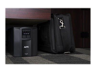

Intelligent and efficient network power protection from entry level to scaleable runtime. Ideal UPS for servers, point-of-sale, routers, switches, hubs and other network devices.
SmartConnect
Innovative, easy to use remote monitoring feature that provides automatic notifications, firmware updates, and advanced support services. -
Software package
SmartConnect software for remote power monitoring feature availability varies by terms of use -
Communication port support
SmartConnect Ethernet port for cloud monitoring feature availability varies by terms of use -
High online efficiency
Reduces utility costs, generates less heat. -
Green mode
Patent-pending operating mode that bypasses unused electrical components in good power conditions to achieve very high operating efficiency without sacrificing any protection. -
Energy meter
Provides actual kilowatt hours of usage for energy conscious users. -
Predictive replace battery date
Dynamically provides the month and year when battery replacement is recommended to aide in long term maintenance planning. -
Intuitive LCD interface
Provides clear and accurate information in multiple languages with the ability to configure the UPS locally with easy to use navigation keys. -
Single switched outlet group
Single outlet group that may be controlled separately from the UPS for discrete reboot of hung devices, sequenced on/off and non-critical load shedding. -
Pure sine wave output on battery
Simulates utility power to provide the highest degree of compatibility for active PFC (power factor corrected) servers and sensitive electronics. -
Cold-start capable
Provides temporary battery power when the utility power is out. -
Intelligent Card Slot
Customize UPS capabilities with management cards. -
Temperature-compensated battery charging
Prolongs battery life by regulating the charge voltage according to battery temperature.
